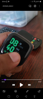

I've an Fitbit versa 2. I'm facing display issues with it. I could see time in background if I open menu or other apps. Time displayed in background is incorrect. It seems screen has some issues. I tried reaching Fitbit customer service. It was one of the horrible experience and worst service. They don't have basic knowledge. I'm from Chennai, India. Any help where can I get this fixed?

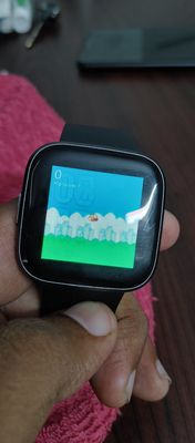

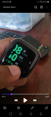

Thanks for the reply.. I've factory reset the watch also. I don't face issue with current time. I'm getting those time display when I navigate to other menus which is not correct. When I navigate to other menu's also the place where time is displayed have some traces. I've added some images. Please do check left side screen.
Hi @Balaji.R  - the screens look normal.
When you navigate you swipe the screen edge in a direction. If you drag the screen then you can see more than one screen at a time, like scrolling instead of swiping.

Thanks for the reply.. Yes you're correct.. if we drag the screen I can see other half screen.. Issue which I'm referring is attached as pic.. kindly check it and let me know if anything can be done.. check left side screen you can find the time is showing which is incorrect.. Picture taken at 10:09 PM IST
@Balaji.R- in the case of that photo, in all probability it is a fault with the clock face you are using.
First try with another clock face.
If it is fine - then either contact the developer at the bottom of the install description or choose a different clock face to replace the faulty one.
