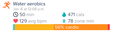

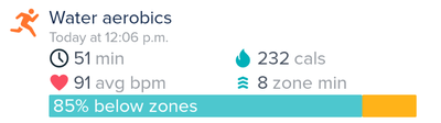

Count me in for experiencing this problem too. I switched from using a Versa 2 to a Versa 3 a week ago, and couldn't figure out what was going with my stats!
Check out my aquafit stats... The instructor was the same in both instances, but Jan 6 was Versa 2 and today was Versa 3.
