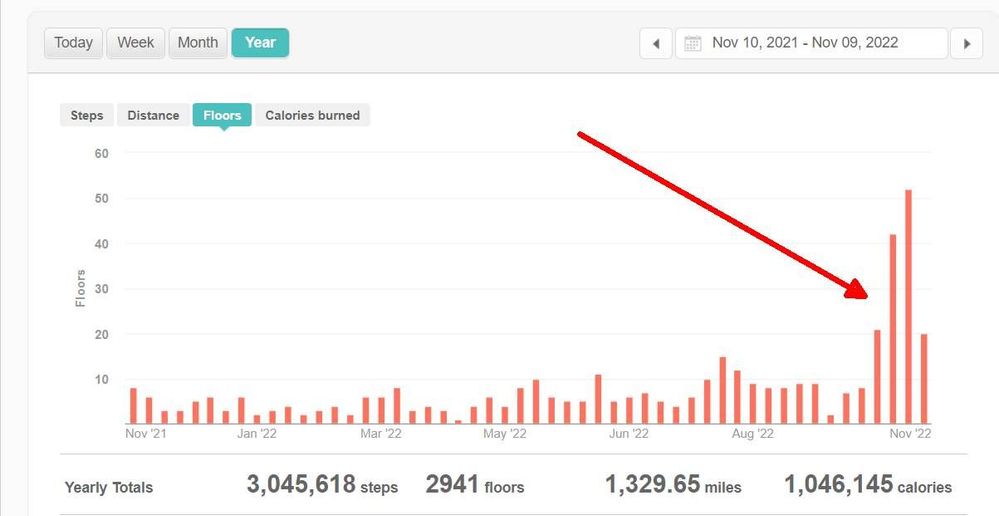

Just got my second Versa 3 replacement within the 1-year warranty due to this problem. First agent had me reboot it. Second agent had me reset it. Still had the problem. 3rd agent did the replacement. I did the online chat, and it wasn't too bad. If you're under warranty I would keep at them. I figure I know have 6 months to figure out what brand of watch I'm switching to when this one dies. First one bricked itself and got stuck at the logo screen and never recovered. I see a lot of posts about these two problems all over these support boards. It looks like it went back to normal at the end of the graph below, but that week was just starting, so it looks low still. It ended up being the biggest week yet! Good luck!
