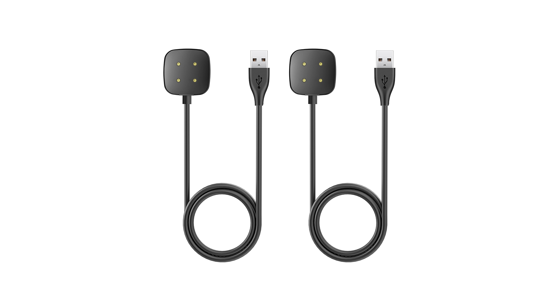

FYI, I bought this (two cables in case it happens again)

Yes they sent me a replacement but I bought one before theirs arrived. Their replacement works but its pins are similarly very shallow, it'll probably
develop the same problem. I put it in my travel luggage
09-04-2022 08:16 - edited 09-04-2022 08:16
PS I'm looking at the pins on the charger I bought from Amazon, and its pins are short now, about 4 months later. I guess the answer is that this design is poor. Buy several replacements and don't leave it charging for a long time
