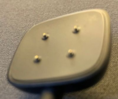

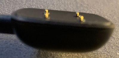

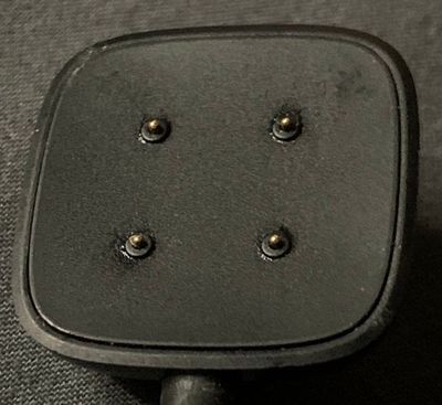

Here's the stock charger that came with mine
The shine is from nyogel (sane stuff I use on all my high performance flashlights and 2-way radio power connections)
This is a side shot of the aftermarket charger (that actually works, so I don't have a small expensive paperweight)

The pins on mine all look perfect as well.
The factory charger still doesn't work.
They say not use use 3rd party chargers, well the 3rd party charger (bottom picture, you see the longer pins) works fine.
