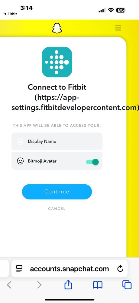

My other issue is still unresolved.  No, I'm not getting any error message when I try to get the Bitmoji clock face.  I'm familiar with the process since I had it on my Versa 2 until it died.  I went to the Versa 3 specifically so I could keep the same clockface.  The hangup seems to be when I try to 'connect' my Snapchat to Bitmoji.  I have both accounts.  I have uninstalled and re-installed both.  I'm able to use my Bitmoji on my texts without issues. (I have an iPhone 16 ProMax). When I am in the Fitbit app, I've selected the Bitmoji clockface, given all 'permissions', go to Settings and chose 'connect' to Snapchat.  The next screen is this and it jiust seems to be stuck and will not  Authorize Application  Snapchat 2.jpegconnect .  I hit 'Connect, Continue & Open' and it just keep going in the loop but will not connect.
Hi @MzBiddle. Thanks for getting back to us and for adding your screenshot. I'm glad that you were able to correct the weather units and will   be happy to continue assisting you.
