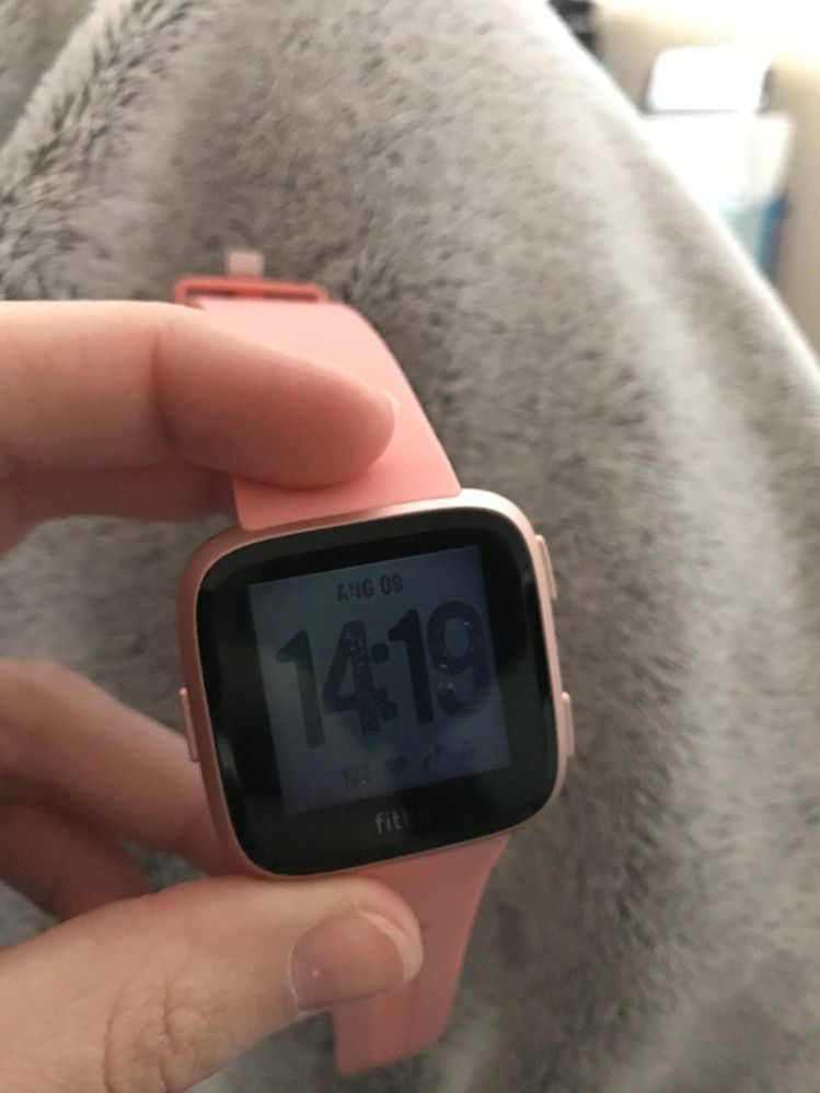

Yesterday my Versa was working perfectly and this morning the display went all pixelated, colours inverted and faded. I tried rebooting it a couple of times but no difference.

Restart it a couple more times and if that doesnt work do a factory reset - via the settings app on the watch and scroll down to About if you can navigate there, but using the button if you cant. If that doesnt work younwill need to contact Support (link in my signature) Let us know how you go
Restart your tracker
FACTORY RESET USING BUTTONS
On the watch, hold all three buttons for about twelve seconds. This triggers the 2-button hardware reboot after about eight seconds.
- When the Fitbit logo appears, then disappears, release the bottom right button, then continue holding the left and top right buttons until you feel a strong vibration. This indicates the factory reset was initiated.
- This process may take several seconds, and eventually, the Fitbit logo appears and the device boots and displays go to Fitbit.com/setup.
- If you fail to release the bottom right button in time, or otherwise don't follow the procedure precisely, the Fitbit logo reappears quickly and boots without factory reset.
If the device turns on, please go back to the Fitbit app and setup your device back to your account with these steps. Make sure your watch is plugged into a wall plug or a computer, next to the router and that there are no other trackers or devices with Bluetooth on nearby when setting up.  Please log into your account, go to account on the upper right corner, there look for "setup a device" and tap on it. Follow the instructions on the screen and let the watch charge for 2 hours.
