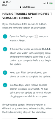

What version do u have when u go into ur Fitbit app? I did as she told me & it worked!!! My watch is running perfect! Plug the watch into the computer, u may need to update a few times until the watch updates to the proper version! Hope this helps. I can find the original email & copy & paste it if u like...???
I did a factory reset after which fitbit logo comes and doesn't when i try to setup it doesnt detect versa lite, I pluged into the PC and tried also it didn't work
Yes maybe you can try pasting the original email maybe i can get some help from that
 this is a screenshot of the link I was given. Hope this helps😊
