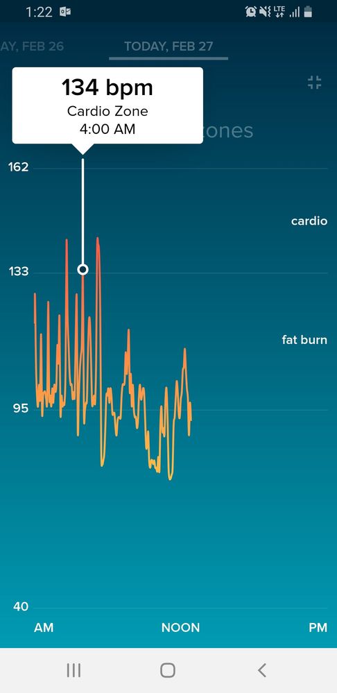

@Chartness can you please post screenshors of your daily heart rate recordings? Also recordings of HR from the workouts. I would like to see how it looks across the board.

Here is one from today.  The spike I have selected was when my watch was not on my wrist.  The next spike was during my workout, but was not registering the ~158 I was getting to.
@Chartness Is the sensor blinking when not on your wrist? I make sure that the tracker is belly up so the sensor doesn't get confused. It happened to me before that I would get similar reading when sensor was turned towards glossy surface or some fabric. Do the spikes happen while on your wrist and not in the workout mode? E.g. when you're in bed?

The spikes will occasionally happen when I'm not working out, but I do not wear my watch to bed.  Those spikes on the picture occurred when the watch was on the charger.  I have noticed that is when the issue is most likely to occur.
@Chartness ok, this should not be happening when the watch is on the charger. I'm not talking spikes, because spikes are a normal occurrence throughout the day, but it should not measure any HR when on the charger. The standard route is to perform several factory resets. If this does not help, definitely reach out to Customer Support. This is indeed weird.
