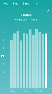

And @Z06tim , I'm not lazy; here is my three month average mileage and I hit eight miles today, most days on the treadmill for an hour, twice a day at 3 mph - my left knee won't handle running anymore. The four mile target was given to me by my Cardiologist. Do you have some data to support your claim of laziness for FitBit users? How many miles a day do you average?
