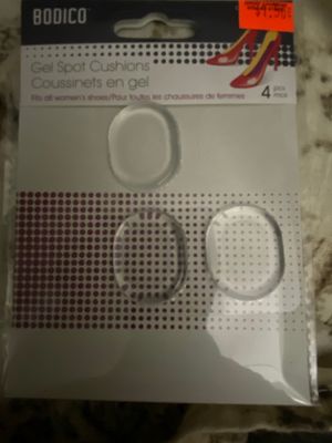

I ended up trying these clear toe protectors that I found at a dollar store. They are gel and are very comfortable and work great!
