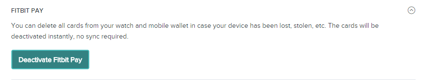

I found a setting in my online profile that might help.  Even though I had never enabled it, I pushed the button that deactivated Fitbit Pay.maybe nfc will stop buzzing at tuzzy now.PNG
Well, buzzing still happens whenever I walk through the detector at the library.  This is even having pressed the "Deactivate FitBit Pay" button on the fitbit.com site in my profile. There's nothing in the Wallet.  Today I checked using someone's Android phone that does NFC. There's an app called "NFC Tools" on Google Play. It was able to activate the NFC in the Fitbit Versa, just like what happens in the library (doing nothing to the watch).  And I tried using one of those RFID Credit Card Sleeves wrapped around my wrist to block the reading.  It didn't work.
