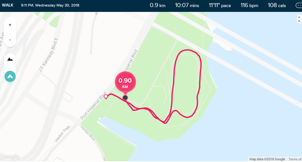

First, I took the Blaze on a small elliptical route near my home. It took merely 5-10 seconds for it to connect to my phone and get a lock on the GPS. Then throughout the 10 minute activity it did not lose connection with my phone, which happens to be a Google Pixel 2 running Android 8.1.0. Here is a screenshot for verification.walk_blaze.png

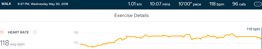

Clearly, it was a 0.90 km walk for about 10 minutes.

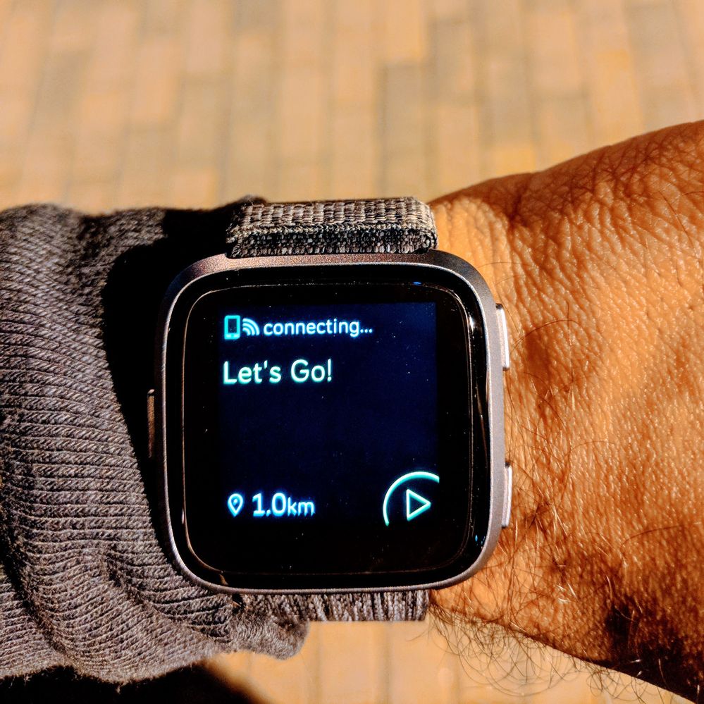

Next I tried the Versa. I tried for a solid 10-15 minutes to get the GPS to work. Nope. Absolutely no use! You can see the Versa just stuck on "connecting..."  as seen in the picture below. Note that the Blaze worked flawlessly within 10 seconds, and WITH THE SAME PHONE!!!
The phone also showed me that connected GPS was infact indeed running, in my notifications. Anyway, here is the proof of the failure!
As you can see there is no GPS data and so no map!

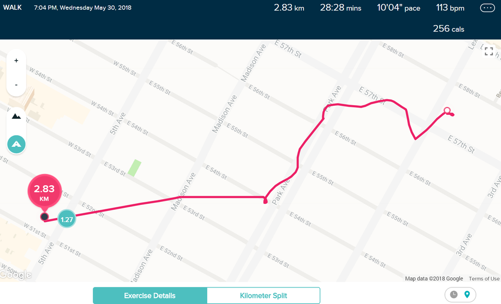

In Versa's defense, earlier in the day, it did manage to get some GPS data. I walked for about 2.8 km, but instead of logging the GPS data for the whole walk, it only logged it for the first 1.3 km or so! And it took a lot of time to even get the GPS data connection to begin with! But halfway in the walk it lost the connection and never recovered. Take a look!
See! At around the 1.27 km mark it promptly loses GPS connection. Also it seems to think I can walk through solid buildings, based on the diagonal line across some blocks. Clearly there were more GPS tracking issues.
