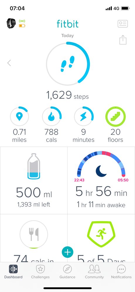

Walked up one 12 step flight of stairs this morning and 20 floors! This is getting silly! 9 minutes of activity as well - have woken up, driven to work and that’s it so far.ABD18392-8C45-4943-8C50-C1D89B5CD520.png
