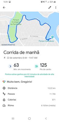

I'm having a similar problem. Google Fit (whichis correct) and Fitbit showed different distances.

I have a Samsung S8 but it was working fine until the past couple of weeks when the app updated! Since then I've been having endless problems!
Best Answer09-27-2019 07:36
09-27-2019 07:36
My phone is a Samsung Galaxy S9+. I don't believe that is a compatibility issue because I've been using the app for more than a year without any problem.
This issue started to happen after the last app update, on September 19th.
