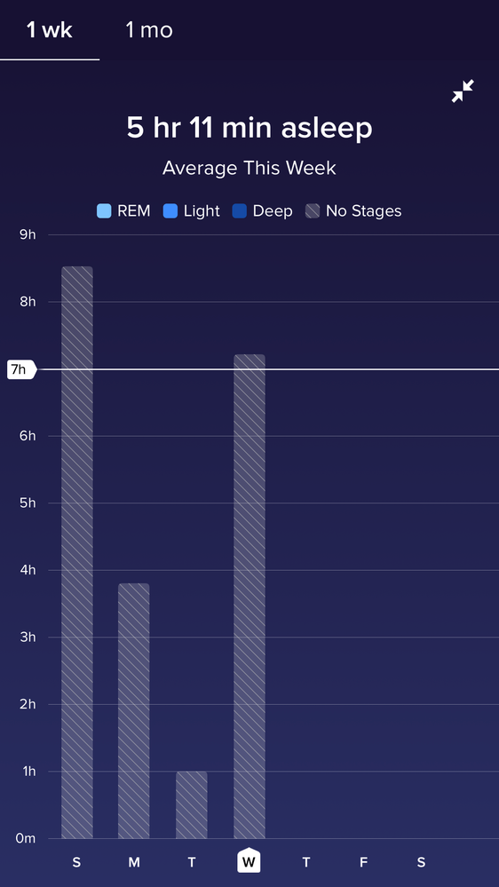

My fitbit versa dont registrate my rem, light or deep sleep. It only show «no stages». It’s set om sensitive sleep registration. Anyone know why?

@JessicaBerg1990 If you move a lot and have set the sensitivity to Sensitive each movement might be interpreted as awake (and not simply brief time awake but up). Versa determines period of time as being asleep after 1 hour of inactivity, and it needs at least 3 hours of recorded sleep to determine sleep stages. Try changing your Sleep Sensitivity to Normal. Also, reboot tracker just in case. You can do that by pressing and holding the left and bottom right buttons until fitbit logo flashes.

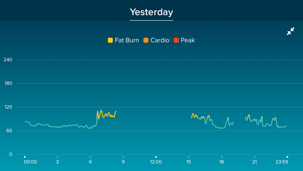

@JessicaBerg1990 Can you please post screenshots of HR recorded for these nights (from Fitbit mobile app)? Also, do you have any bedtime targets set in the Fitbit mobile app? If yes, please clear them.

@JessicaBerg1990 I meant screenshots of heartrate recording for the whole night/day. 😊

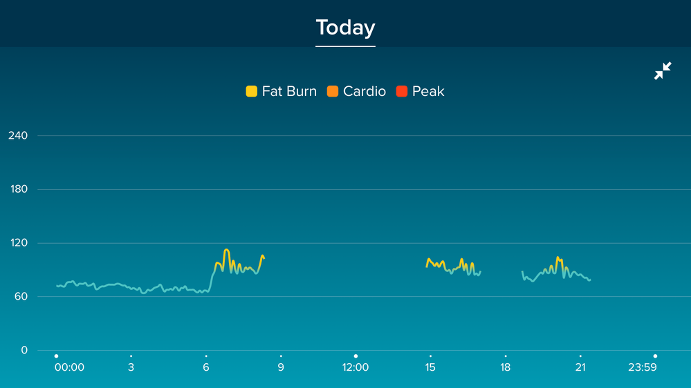

ttoday’s HR 😁

@JessicaBerg1990 I just wanted to verify that HR is being recorded at night. Let's hope that clearing bedtimes (don't forget to sync after doing that) resolves the issue. Btw, I need to ask, why do you have such gaps in HR recordings between 9 and 3 PM? Do you remove your tracker?

Let’s cross our fingers that it works👍 I’m not allowed to wear it at work,Thats why. So i dont use it st daytime😬

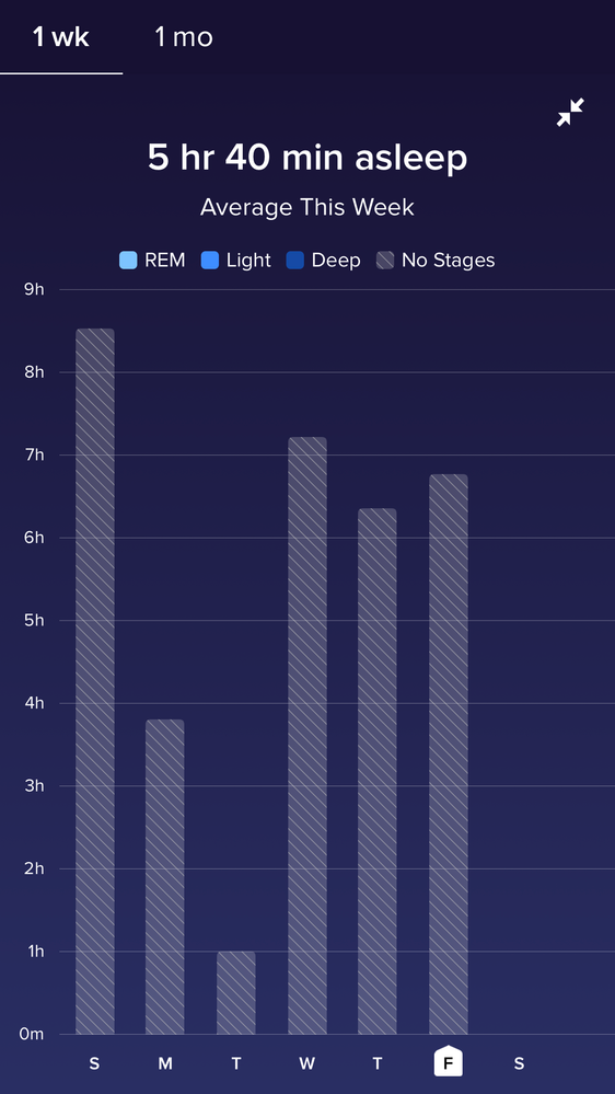

It stil did not work 🤣😫 tonight i think i should try have my fitbit on the other hand

@JessicaBerg1990 What really baffles me is that it shows you have 0 awake minutes... I mean c'mon... Not even one? Try the other hand, but something is not right. If you have tried several reboots already, I would try restoring Versa to factory defaults and see how it goes. Factory reset will wipe all the data from the tracker, so sync it first. Before factory reset, make sure you have deleted versa from your Fitbit mobile app and from your phone's Bluetooth settings. To perform factory reset, open settings app on you Versa and scroll down to About. Tap it and choose factory reset. After factory reset you will need to set up your versa again by adding a new device in your Fitbit mobile app.
