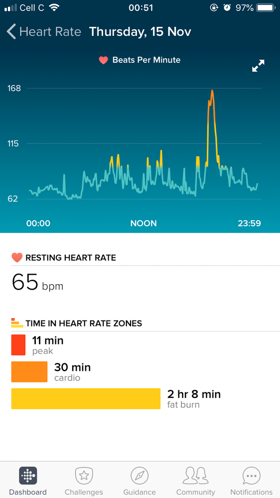

Hi @Marrrmaduke@AlejandraFitbit please see screenshots attachedBefore the issueBefore the issue

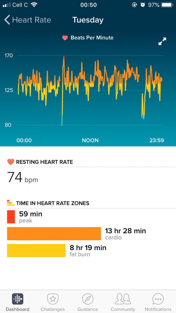

After the issueAfter the issue
@OMak55 You're correct. This is not right. You can try toggling the HR sensor of your Versa ON and OFF as well as turning Versa OFF for several hours and then turning it back on to see if this improves anything. If this doesn't work, then my advice would be to perform factory reset (wiping Versa and restoring to factory defaults). Before performing factory reset, please sync your tracker. Anything but steps data will be rubbish of course, but at least this you can salvage. Let's do a clean install:
