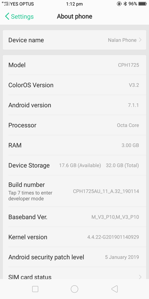

I have an oppo, please find device info on attached pic

@Nalan77 Were you able to make heart rate work with the tips I provided in my earlier post? Are the sensor lights blinking? To restore bluetooth connectivity, please try this:
  1. Unpair (remove) Versa from your phone's bluetooth settings
  2. Uninstall the Fitbit mobile app
  3. Reboot your phone and install Fitbit mobile app. Do not pair in your phone's bluetooth settings. The trick here is to not pair in phone Bluetooth settings but rather let the Fitbit mobile app do that.
  4. Reboot your Versa by pressing and holding the left and bottom right buttons until Fitbit logo flashes
  5. Login to Fitbit mobile app
  6. Grant all permissions and sync
  7. Make sure that Sync Service notification for Fitbit mobile app has the priority set to at least HIGH (this can be done in the Android settings>Notifications>Fitbit)
  8. Make sure All-day sync, Always Connected are enabled in the Fitbit mobile app. Make sure to sync after enabling them.
Additional tips if sync issues persist: If you have Wifi set up, go to Fitbit mobile app and remove it, then sync your Versa. I noticed that it causes issues for me. If you have other Bluetooth devices paired with your phone, forget them. One of them might be causing issues.
If you have issues with the notifications, please do the following:
  1. Turn OFF the Notifications in your Fitbit mobile app and on your Versa, reboot your phone and Versa, and turn the notifications back ON on both devices.
  2. Make sure the notifications are ON on your Versa. Press and hold the left button to access quick menu. Turn the notifications to ON.
  3. In the Fitbit mobile app, make sure you enabled the notifications and that Fitbit notification service is enabled in your phone settings. It needs to be ON.
  4. If your phone is in DND or silent mode, make sure Always vibrate option is enabled in your Fitbit mobile app. Also, it's always a good idea to toggle on/off notifications in the Fitbit mobile app with sync in-between.
  5. Make sure that any app you would like to receive notifications for on your Versa has the push notifications priority set to at least HIGH (this can be done in the Android settings>Notifications). Please see my post here for more info.
  6. Also, please make sure Fitbit mobile app is not being optimized by Android (Android settings>Battery>Optimization>Fitbit needs to be marked as not optimized).
  7. Finally, Oppo and OP phones are known for extremely aggressive power management. Anything remotely more active gets killed including Fitbit mobile app. You may need to lock the app in the background by using screen pinning. Please see my post here.
If everything fails and sync is still not stable, perform factory reset as described here, and/or downgrade fitbit mobile app to version 2.74.2.
