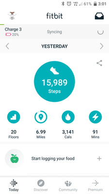

You can see here I have done 6.99miles but the circle is not closed.

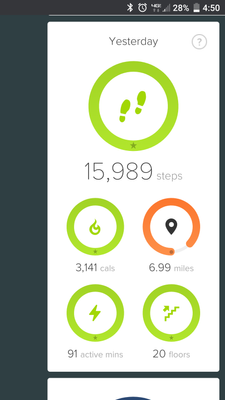

Yes the same problem occurs.....for yesterday my target setting was 4 miles.  The circle on the link above is showing 4.6 miles but the circle is not closed.  Thanks

Yes even when I log into Fitbit.com I see the issue.
See screenshot
