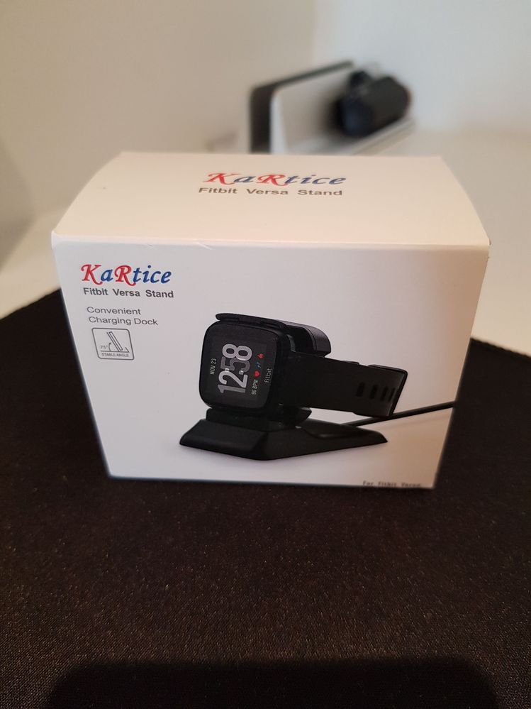

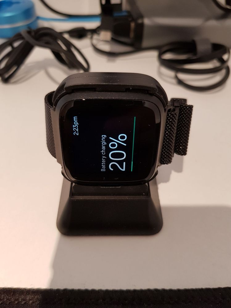

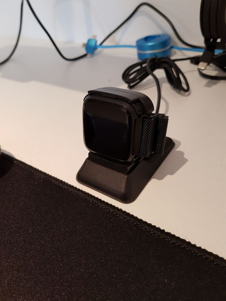

Just get a third party charger. I just got this one to test and compare. It's way easier and better than the original.
Update: In the last 8 minutes, it's charged from 20% to 32% so definitely faster.
