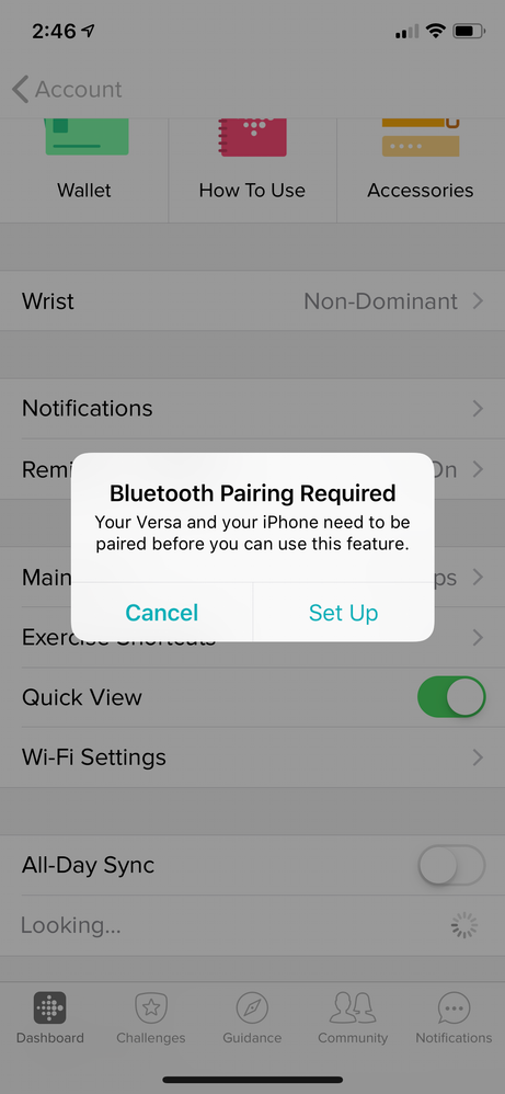

I have read all of these links and nothing is helping. I have a Versa and an iPhone XS. The sync works, as I can see my steps and heart rate and sleep patterns, etc, but I don't receive notifications. When I try to go to the notifications setting in the fitbit app, after waiting a long time, a pop up comes up to say All-Day Sync is now turned off. At first I thought I was just missing some notifications, but then I figured out that my old iPhone 6 was sending the apple message notifications through (so I got my husband's text messages) but the iPhone XS sent nothing (so I miss calls and texts from people using my phone number without Apple messaging). Please help.

Mine still does not work. Idk if it could have something to do with my WiFi?? After I tried the suggestions above I couldn’t get it to sync at all. Then I restarted my phone & still nothing. I took my old phone to the gym just in case, but then all of a sudden my heart rate started showing up. Came home & tried to get to notifications, & now they sync won’t work at all again.

I have tried the three steps listed in the earlier post and turning Bluetooth off and on. I have also restarted both devices (versa & iPhone XS) & updates the iOS.
When I try to get to notifications or turn on all day sync, I get a message that I need to pair. If I go through the Bluetooth settings I also get an error message. It acts like they can’t see each other, but I am still getting FB local notifications and my steps are still there. Also it says it synced at 2 am this morning. So idk how it isn’t pairing.
Best Answer11-12-2018 19:12 - edited 11-12-2018 19:12
@HeatherMN At this point I would try deleting the tracker from the Fitbit account and performing factory reset. I would also forget Versa from the iPhone's Bluetooth settings and reboot the phone. After factory reset, Versa will have to be linked to your Fitbit account again (set up). As factory reset wipes all data from your tracker, please make sure you synced.

I need to google how to do that. I synced then removed the device in the Fitbit app last night, & did the set up again, but that didn’t help.
