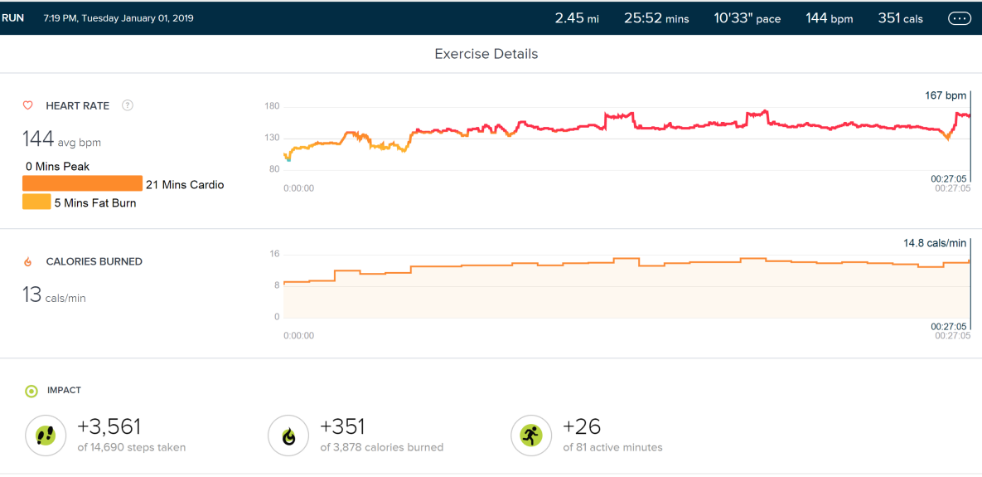

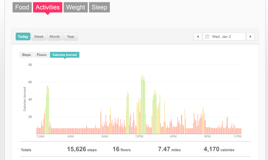

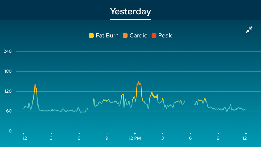

The calories for the activity already include your BMR but also heavily depend on your HR. I need to see some screenshots, especially for:
  • heart rate recording for that jog (fitbit mobile app or fitbit.com)
  • heart rate recording for the whole day (fitbit mobile app)
  • calories burned chart (calories per hour) from fitbit.com
  • calories burned curve for the jog (fitbit mobile app or fitbit.com)
Marrrmaduke | Canada
Charge HR, Blaze, Charge 2, Charge 3, Inspire HR, Versa Lite, Versa SE, Aria
@tdubbs1212 Thank u for posting screenshots. That's exactly what I need just for different days. The jog took place on Tuesday, 7:20 PM. I need all the other charts for that day not Wednesday. Unless the calorie burn per day was ok for Tuesday and it's only Wednesday that is problematic? I see 2 large heart rate activities on Wed (around 12 am and 12 pm). Did you perform any activities? Regarding Jog workout itself. The calorie burn is right and aligns with the heart rate. So, I am more curious about your daily calorie burn if indeed it's over 4000 every day...
