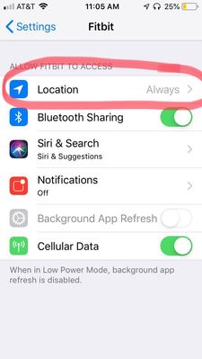

I had the same problem.  In order to attempt to save battery life I had changed Location Services in the Fitbit app on my iPhone from Always to While Using The App.  Suddenly my weather app on my Fitbit Versa stopped working and kept telling me to sync.  I switched the Location Services back to Always and the weather app started working again.
To switch Location Services on the iPhone, go to Settings-Fitbit-Location and choose Always.
I’m not sure about the privacy aspect of having Location Services always on but I wanted the weather app to work so I did it anyways.
I hope this helps.
My versa weather app kept telling me to resync to get weather info. I did that several times with no luck. Then I deleted the Fitbit app on my iPhone and tried again. Still same problem. Then I went into my iPhone setting for Fitbit and tried a few things. After I changed the location setting to “always”, the weather app worked again. I preferred to keep this setting on “when using app” but obviously some things don’t work on my versa unless it is “always”. So FYI.
