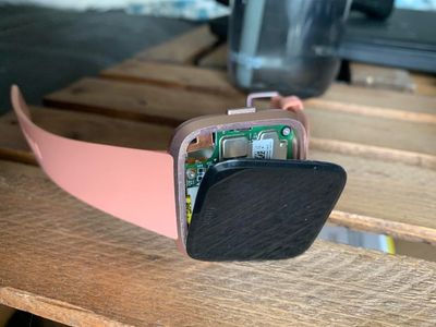

The screen on my Versa fell off, I was not doing anything, I came home from work and noticed the screen has just fell off. Had this happened to anyone else? it's less than a year old, purchased on September 2018 :(. $200!

Hi, I am sorry to hear you are having issues straight out the gate so to speak. If your fitbit is under warranty still, call support and request a replacement. They are great while things are still under warranty. For me, yeah I was deeply disappointed to see yet another fitbit fail in under 2 years. I don't plan to replace mine. Not sure what if anything I will replace it with just yet. Good luck
03-20-2020 05:57 - last edited on 05-08-2020 19:30 by LiliyaFitbit
I haven’t tried to glue it yet. Seeing if anyone else has and what
locations. I absolutely love my versa. But I also am gravely concerned
because I didn’t even take mine anywhere near water. I babied it. I’ll
keep you posted

From my experience, gorilla glue tends to foam up her expand something to that extent. Did you see any sign of that? What kind of gorilla glue did you use. There's so many different kinds now. The one I experienced with the foaming / expanding was the original. I'm guessing the gorilla glue brand super glue probably doesn't do that.

My screen is useless. Tracks steps and time but cannot switch screens since glueing back. Good luck.
Good thing but habits die hard – especially when I need to get my steps in
Thanks for your response. The screen is basically locked no on the initial screen and cannot use for any other applications. I have come to rely on it so its hard. Looking for another smart watch.
Good lucl and thanks for responding.
Yep I baby mine too. No swimming – no showering perhaps that was the problem. The glue dried out!

Anyone reading this thread: DO NOT USE the original Gorilla Glue. It expands, is not clear, and will ruin it! I'm assuming that the user who got this to work used Gorilla Super Glue...it is clear and fast-drying.

I used super glue. Clear. I put a small bead across the top and bottom. I
didn’t want to do all sides for fear it would damage it. So far it’s
holding and works fine. A little disappointing I had to take that measure
but I do love my Fitbit. It just makes me question any future purchases of
one.

I’ve had mine for about 18 months. Swam with it several days a week for the first 12 months without any problems. Hasn’t been wet since July. Last week I rinsed it off...couple days later the face popped off. Still attached, but won’t stay locked into the frame. I was afraid to use glue. I went back to wearing my old Blaze, but missed all the extras that the Versa has.
My solution for my Versa was a soft full cover case/screen protector. I ordered it on amazon - $8 for three covers, variety of colors to choose from. You have to take the cover off (gently!) to charge it, but other than that I’m happy to have my Versa back up to speed!!

Do you mind sharing or linking where you got those screens from? I did
glue very gently a bead across the top and bottom of my screen and it held
tight. I dare NOT get it wet now though. I LOVE my Versa, so I'm not
willing to give up on it yet. If just for the motivation it gives me
tracking steps, and developing healthy habits -

Had a similar issue on my Versa. Unit was less than 24 months old. Glue around the edge of the screen was rather soft and seemed to have lost its ability to hold on. To repair the issue I used "sensor safe" RTV and put a very small bead around the case lip and then placed a heavy book over the screen over night to allow it to seal. About 24 hours after the repair and everything is going well so far with 100% functionality.
IMPORTANT: Do not use anything but sensor safe RTV, regular RTV releases chemicals during the curing process that will destroy electronics. Given this will be right next to your phones guts and an enclosed space, regular RTV will destroy your watch.

This happened to me last week. Same age as everyone elses tracker on this thread.
When I mentioned to support it happened the support rep (which I full acknowledge it is not the support reps fault and they did an absolute wonderful job) I was told, that it is a known issue that FitBit is aware of, and there is no known resolution but to buy a new one.
