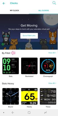

Thanks for stopping by @GracieLucyTo see which clock options are from Fitbit, open the Fitbit app and tap or click the Account icon:
User-added image
After this, select your device image. Tap on Clock Faces. There you'll find a By Fitbit option.
I hope this helps, keep me posted! 🙂

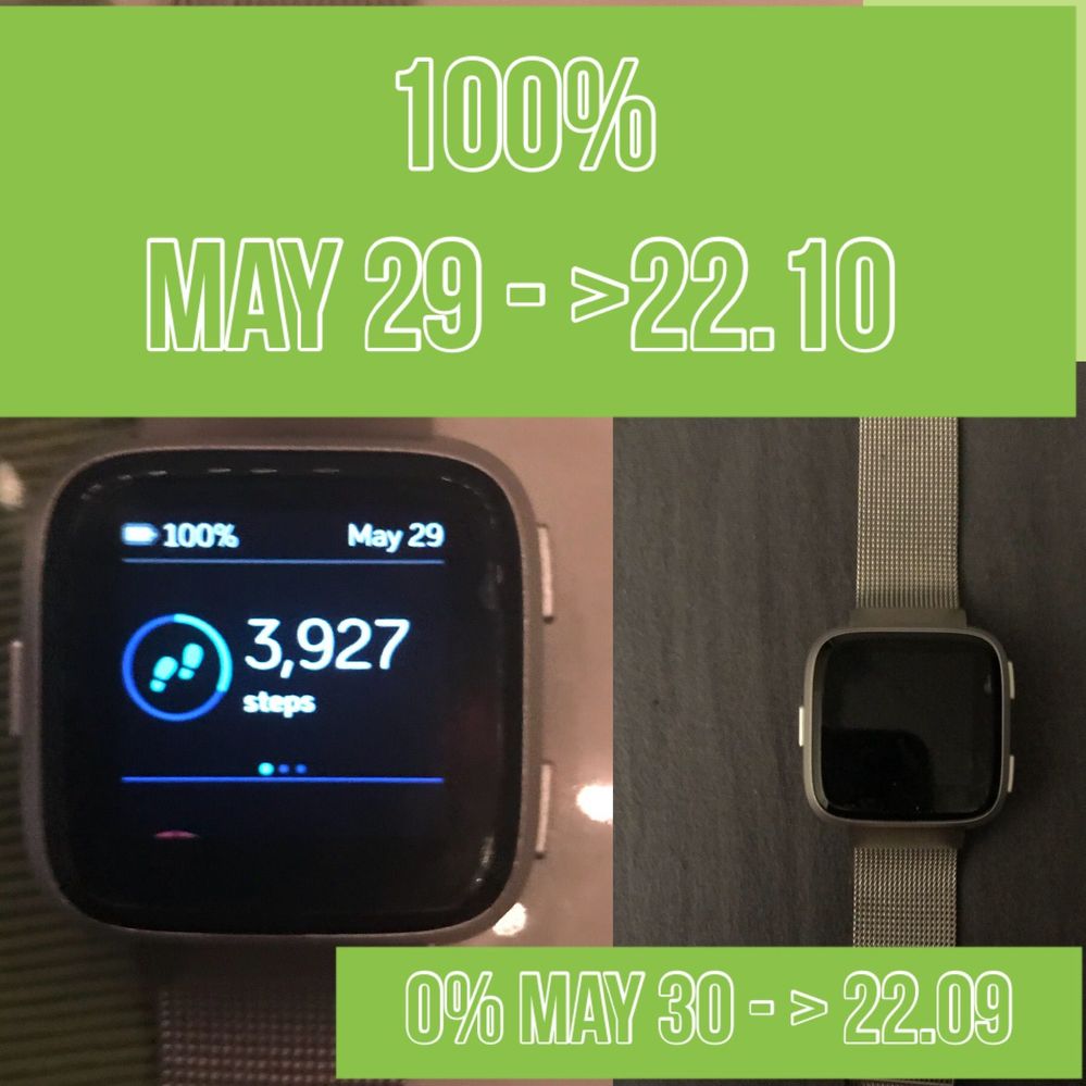

Yes same problem her. Dead in less than 24h
- all day syncs off
- Fitbit clockface
- no app notifications
- non alarm set
- screen off ( only activat whit button)
- reminders to move off
- factory reset done
i have many Fitbit’s  sinds 2011 but this one looks and feels great but the battery  is just terrible
I contact Fitbit support so I let you know when I have a sulution
- the will sent me a new one
- 31/05/2018 Fitbit sent
- 15 /05/2018  recived replacement
battery is Good !!!! I am So happy
