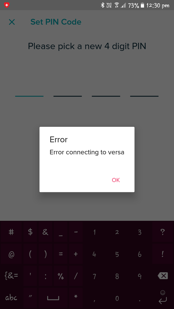

I'm having the exact range problems basically rendering my versa useless. Had alot a trouble switching bans this morning, when I finally got it clicked in the red locked message appeared. I've tried a bunch of times to get this unlocked but get getting "error connecting to versa" and will not let me reset the password. Ve done a reset of my versa about 5 times too. Nothing is working. Screenshot_20181025-123055.png

I was finally successful unlocking Versa using my phone! I had to delete the Fitbit app from my phone (Android) and reinstall it. Hope this helps you.
My problem was resolved by removing the app from my android and starting from the beginning with a new installation.
