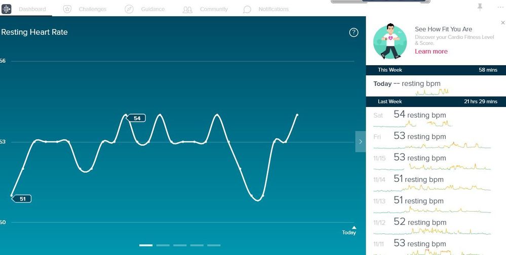

About a week ago my Versa also stopped tracking my sleep. It syncs steps, but NOT sleep. I have taken all the suggested steps to correct this. Removed tracker from App, removed App, reinstalled, restarted, and reconnected. It says it has synced (with computer app, and my Android phone, but only the steps and exercise show up, not my sleep. This is so frustrating that I am losing sleep over it! Is this a problem Fitbit is working on, or is it my watch's problem?

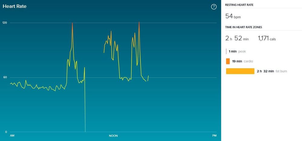

@Troon pls take a screenshot of the heartrate recordings for those nights when sleep wasn't recorded.

Here are some screen shots. The previous 5 days do not show at all, although the steps show. Thanks!

@Troon Thank you. It seems like the HR is recorded just fine. I wanted to make sure it was as the sleep won't get recorded if HR can't be detected. Other reason can be trackers low battery. If that's not your case, I would suggest performing a factory reset and setting up everything from scratch. You will need to sync Versa before performing factory reset as it will wipe all data on your tracker. Also, you will need to delete the tracker from your Fitbit mobile app and your phone's Bluetooth settings. After that, reboot your phone and wipe your versa. You can do that by opening Settings on the tracker, scrolling down to About and tapping Factory Reset. Set up Versa as a new device in your Fitbit mobile app.
