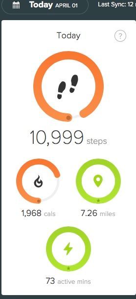

Thanks for the reply. I've restarted the Versa and my phone a number of times, even before my initial post here, but also since then... and, it's still happening. Not everyday, just once in a while. Today, for example (see attached image) my Versa tells me I have covered 7.26 miles so far in about 11,000 steps. That's a stride length 3.48 feet (~42 inches)!
My running stride length is set for 32 inches and my walking stride at 30 inches, and when I run or walk a marked course it is a very close match depending on the hills.

Here's the image of today's erroneous mileage... I forgot to attach it. Thanks.

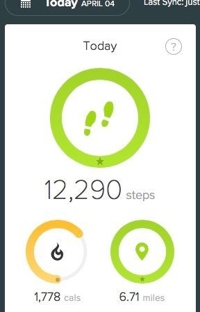

I am starting over. I have removed my calculated stride lengths that took months to establish, and I am letting the Versa auto-calculate stride lengths - it's showing 27.3" for walking and 31.4" for running. I have done minimal moving around my small house, then a 4 mile run this morning, and about a mile of walking. However, I am already seeing issues with mileage for the day - 6.71 miles is simply too much and not correct based on number of steps and stride length:
Here is the math:
6.71 miles X 5280 ft/mile = 35428.8 feet
35428.8 feet /12290 steps = 2.88 feet or 34.6 inches/step
This is nowhere near the largest auto-calculated stride length of 31.4 inches that the Versa indicates it is using to calculate distance.  So the error is not originating with stride length - it's an error in the mileage, and it just started recently. And yes, I have  done the multiple obligatory restarts on the Versa and my phone.
