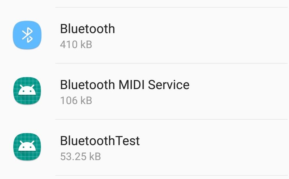

I cleared the cache of my whole phone after booting in recovery. Versa worked for 2 days then the problem reappeared. I will perform your procedure. Which 3 BT processes are you talking about. Could you please share the names? Thx
Best Answer06-09-2018 08:52
06-09-2018 08:52
See attached!

Thank you for your reply. Yes, I figured out that's the processes you were talking about and killed them. My versa stayed connected for about 24 hours and back to the same issue. 😞 I would also like to add that simply killing off processes and clearing the cache does nothing. One needs to reboot Versa as well. That leads me to believe it's Versas OS issue...
ETA: as a side note, all these issues appeared after updating Versas firmware. It's not the phone issue as it was working before. Now, Versa won't sync with anything, be it my Android phone or Pixelbook. The funny thing is PixelBook says Versa is connected but nothing happens. Anybody have idea how to downgrade firmware? I know I can wipe Versa (already did it once) and it will bring it back to the older version of OS but it updates as soon as it connects to Fitbit app.
