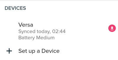

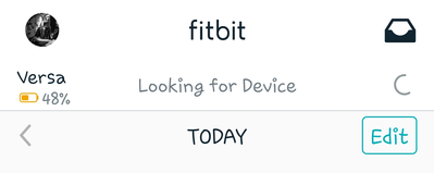

I'm getting to the end of my tether with Fitbit and the Versa. Lately my Versa just won't stay connected to my phone Bluetooth. I use it to keep my phone unlocked using Samsung Smart Lock and it has previously worked flawlessly on this same phone. Now, almost hourly, the phone isn't unlocked and the phone will say the Versa isn't connected if I go into the Smart Lock settings. If I go into the Fitbit app it will almost always tell me the last sync was X hours ago and will often say "Looking For Device" (photos attached, taken as I am writing this). You can see it says last sync was 02:44. That's 9 hours ago, and that's with the app open too. I used to be able to open my app and it was bang up to date unless I happened to catch it between two sync operations which used to be about 20 minutes apart if I recall correctly. Now, the data in my app is NEVER right unless I open the app and sync manually. I get no notifications either unless I open the app frequently. ALL battery saving settings to do with Fitbit are off - it can run in the background, its battery use is not optimised, so there is nothing in the phone settings that should be preventing this.
