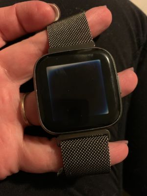

7 months old. Hasn’t turned back on after a swim. Clearly water damage.

@EStarchief I appreciate the image that was attached into your post, it's a shame to know that the display of your Versa is malfunctioning after swimming with it. For us to move on, can you please let me know if do you see condensation or water droplets inside your device that can confirm that it was damaged by water? Did you already try the restart process that was shared on my previous post? If you did but to no avail, please try the factory reset procedure that was shared above and let me know the outcome.
