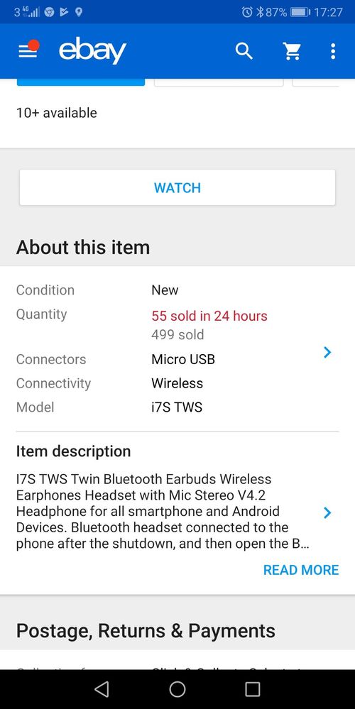

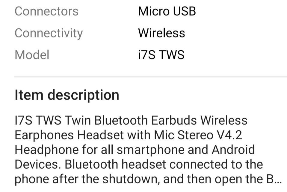

I've since bought a cheaper brand (£10 on ebay) and these work fine!!!! The
versa is working great and sounds great!!!!! 😀

i7S TWS Ear Pods (from eBay UK)
Lisa
