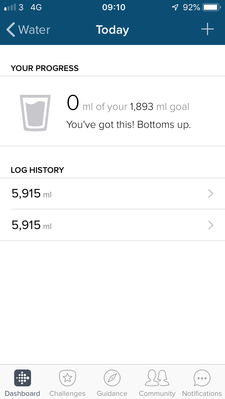

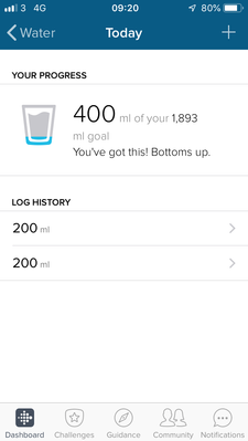

Update on this. I can confirm that the rogue entries I am seeing ARE incorrect interpretations of millilitre entries as US fluid ounces.
A new version of the Fitbit app (for iOS) appeared on my updates this morning and on installing it I checked water on the app. I'd entered two 200ml entries on the watch that morning, but the app was showing 0ml - however, checking the log it showed two entries for 5915ml even though the total was 0. On checking, 200 US fl oz is 5914.71ml - rounding up, 5915.
I deleted those entries, restarted the watch, restarted the app, and entered two 200ml entries via the Versa again and after a couple of syncs they appeared on the log and also in the total. I've attached screenshots of the rogue entries as they appeared in the app and also of the new entries.
Extremely annoying, and implies that something in the sync process - or in the server side analysis process - is a little bit flakey.
.Rogue entries - 200ml processed as US fl ozRogue entries - 200ml processed as US fl oz
 Correct entries.Correct entries.
