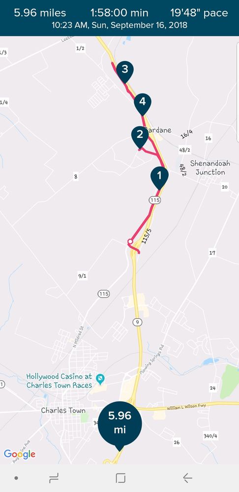

I need fitbit to fifix the connectioconnection issue before the time runs out for me to return it . I ran 8.5 miles today used endomondo app on my phone . my running partner used the Nike app and both apps were accurate . We ran in the open away from buildings and trees . This watch is a huge disappointmentdisappointment . Im not clearing and in uninstalling apps and Bluetooth before every run.  Fitbit knows there is a problem with their watch so FIX IT!  my watch wouldn't stay connected and caused my stats to be WAY wrong . Like my almost 20min mile pace!  so frustrating . fitbit logged 5.96 for an 8.5 mile runfitbit logged 5.96 for an 8.5 mile run
Im thinking the only solution is going to be to return it before stores return policy says its 2 late .
i could deal with a little off but its WAY OFF by miles!
