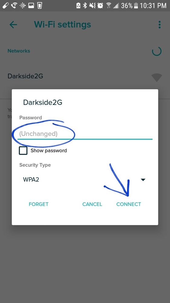

Hi, has anyone else had this problem and been able to resolve it please? Every time I go into my WiFi settings my network is listed but I have to reenter my network password every time. The Versa doesn't seem to retain the network password. Thanks

Is it actually asking for the password or does the password line say "(Unchanged)" and the connect button is available? When I go into mine it gives me the screen to enter a password but I don't actually have to enter it I just hit connect.

Hi thank you for all the help, it does say unchanged, I just assumed i needed to re enter the password. Interesting thing is my phone isn’t listed as compatible so that might be the problem, which is a shame.
