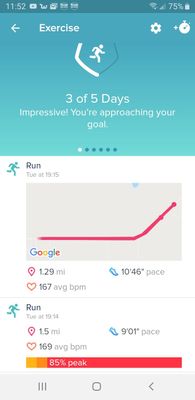

I have made sure when I select exercise then run that my Fitbit is connected to my phones GPS. I've noticed the routes I run with my versa 2 are all .25mi shorter and the pace is 3 minutes higher. I've tracked these routes with 3 other devices connected to the same phone all getting the same mileage. So I know my fitbit is wrong. I really like fitbit it is very user friendly is there anyway I can fix this?

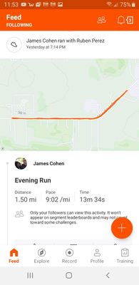

I have measured my stride length steps and running I checked all the settings for GPS and made sure my stride was measurements were correct. I clocked the distance with my car, walked with google maps, and with my strava app all got 1.5mi. My Fitbit is still giving me a higher pace and shorter distance. 2 other apps get and my car get the same distance but my Fitbit is different every time. Its disappointing spending this much money to have this issue. I wish there was a quick fix.
@Jtc381 What I find really weird is that the map recorded is exactly the same so it's not GPS per se. Which is not surprising as both Strava and Fitbit are pulling the same data from your mobile. Have you tried turning off GPS tracking on Fitbit just to see what happens? Also, I would try increasing the stride length for runs - i know it's not an optimal solution but this seems like a weird bug in which some of the distance recorded gets "eaten up". 😕

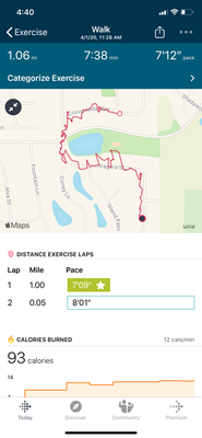

I have a Versa 1 and I've noticed this issue just recently. Something has changed in the App. I've had my Versa for better than a year and half and it tracked just fine until a couple months ago. The odd thing is, if I start the exercise on my watch the steps and mileage are correct. If I start the exercise from my phone app it is incorrect. It would appear that I am walking much faster and it is telling me I have covered a mile in roughly 3/4 of a mile.

If you haven’t already, try starting your run on your watch and not on the app on your phone. I found this to be more accurate than using the app. Not sure why since the watch uses the geo-tracking from your phone to do it. But when I start it from my phone, you can see that it is not tracking correctly.
