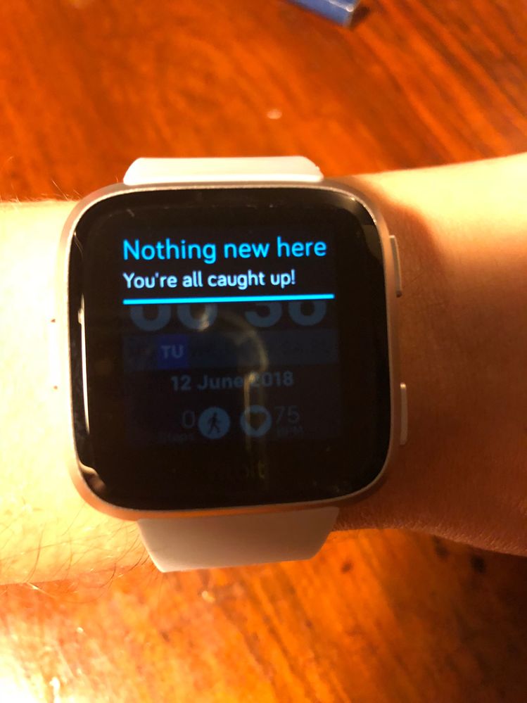

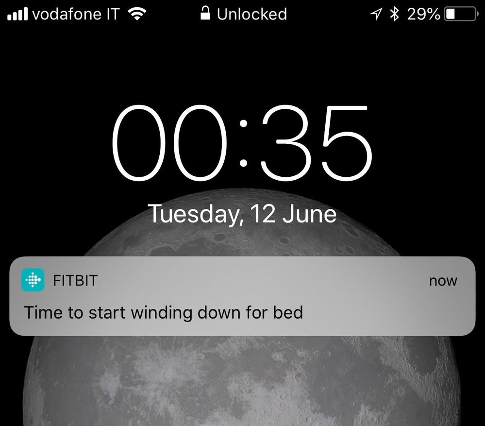

Bedtime reminder appears on the iphone at the chosen time...Bedtime reminder appears on the iphone at the chosen time...
... though no notification is forwarded to my Versa...... though no notification is forwarded to my Versa...

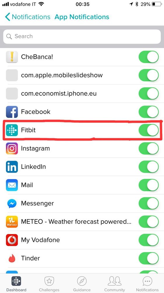

... despite the Fitbit app being duly selected among the apps that can send notifications to the Versa.... despite the Fitbit app being duly selected among the apps that can send notifications to the Versa.

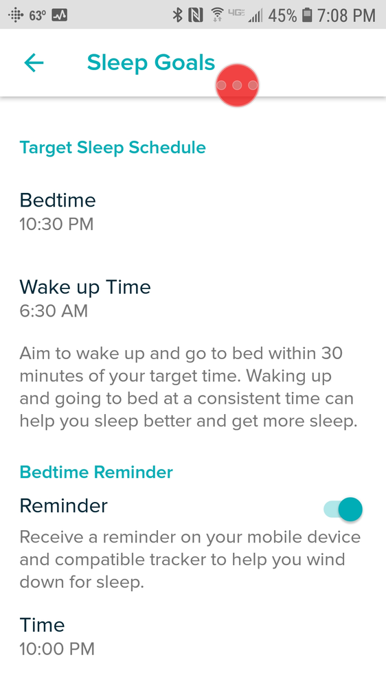

Mine reminds me to go to bed.  Account Icon>Sleep>Bedtime reminderBedtime Reminder.png

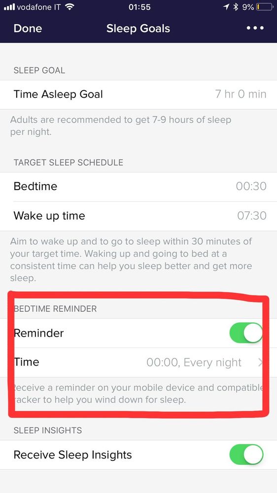

@kcronin thanks for your kind reply! I wrote last post poorly without tagging @Jayelo (who seem to have my same issue). I too have enabled the reminder from the Fitbit app sleep menu (see pic), and in fact I do receive the bedtime reminder on my iPhone. It’s the notification forwarding to my Versa that’s not working, despite all of the right settings. 59936254-1143-49C0-B483-8A971A7549AF.jpeg

Additionally and most important you need to select the Versa (or Ionic) in the Fitbit app select notifications, then app notifications and make sure you turn on the Fitbit app there.
