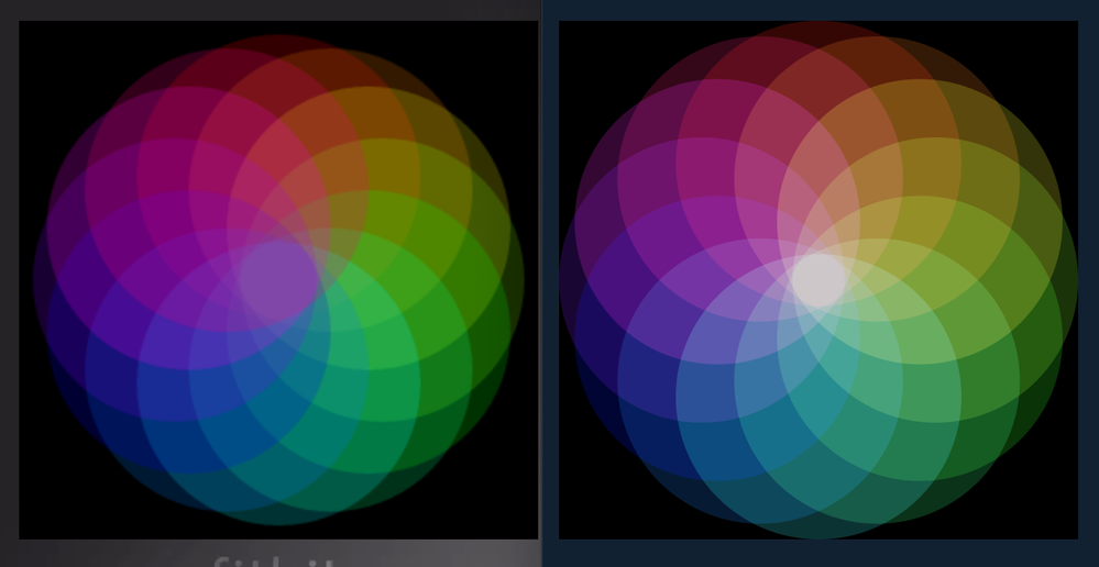

SVG blend modes might be heavy to process but if used wisely they would surely increase the visual experience to a whole new level.
Just for comparison, screenshots of my app in simulator and a sketch made in codepen:
