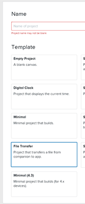

The community is pretty small, so I haven't had luck with finding video guides.
In my experience the easiest things to do is the actual Fitbit application.
I recommend making a few test applications to get comfortable with the API & JavaScript if you are new. Read up on the fibit API a lot, specifically APP - Companion interaction.
After you are comfortable with it more, start with the File Transfer blank project and see if you can successfully send small chunks of BPM (or other data) across to the companion application.
This is your base requirement for offloading data to your WSS server.
The larger hurdle is creating your own WSS web server, this is where I personally decided to stop going down rabbit holes with my project's development.
