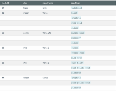

According to the document, if the fitbit device wants to obtain real-time measurement data (such as real-time measurement of heart rate), it must be measured through the Device API.
But I’m not sure what devices are currently supported. From the API content (https://dev.fitbit.com/build/reference/device-api/device/), we can see that versa3/sense can capture the device name through this API.
So......Do the versa4 and sense2 of this series of devices also support Device API?
Thank you for your response.

The very short answer is 'no'. The status is here. There is a workaround that allows the beta SDK to be used with Versa 4 and Sense 2.
