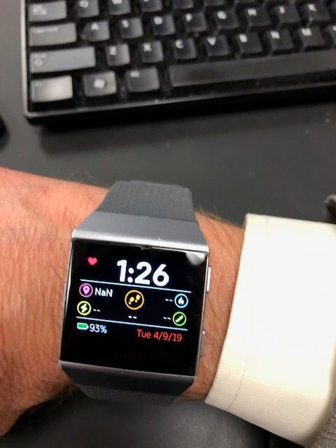

@JonFitbit here is an example from one user that just reached out to me just now. Notice how there is no stat any longer next to the heart rate and the distance is a NaN.
