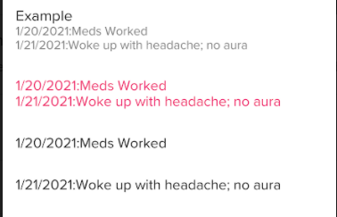

This code block shows a few examples I have been toying with. I am most interested in the button.
<TextImageRow
label="Example"
sublabel={migraineData.map((migraineData, index) => (
<Text key={migraineData.Migraine}>{migraineData.Date}:{migraineData.Note}</Text>
<Button
onClick={() => console.log("Clicked!")}
This produces the following...
Yet, I am not sure yet how to pull individual data out of *.map.
Edit: In addition, it seems that typically, one would use Array.find, but that does not seem to be supported either.
Edit #2: The best option I am seeing for how to accomplish this by creating a button for each record. Then, the user can click it and get a new page with just the info for that record. However, to do that, I need to be able to access the individual record. Thank you again for your help.
