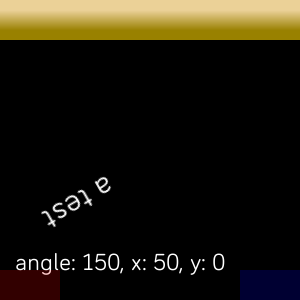

(Versa)
resources/index.gui
<g id="test" transform="translate(50%,50%)"> <text id="test-text">a test</text> </g>
<text id="text-angle"></text>
resources/styles.css
#test-text { x: 50; y: 0%; font-size: 32; font-family: Seville-Regular; text-anchor: start; fill: white; }
#text-angle {
x: 5%;
y: 90%;
font-size: 24;
text-length: 32;
text-anchor: start;
fill: white;
app/index.js
// partial code shown
let test = document.getElementById("test");
let testText = document.getElementById("test-text");
// when relevant area is clicked...
function showText() { test.groupTransform.rotate.angle = angle; testText.text = angle; textAngle.text = `angle: ${angle}, x: ${testText.x}, y: ${testText.y}`;
// testText.x is always 50 and testText.y is always 0, no matter what is shown on the screen }

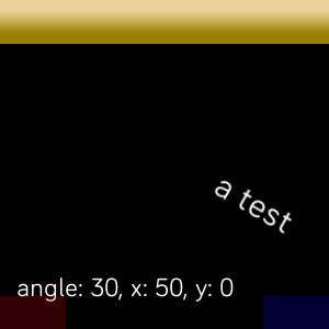

I have also defined an area that, when clicked, increments the text angle by 30.
Changing the angle causes the text to be rotated as expected but the reported x and y of that text is always the same, as can be seen in the attached images.
I was hoping to find the actual x and y that result from any given angle.
(The same would be great for 'translated' components as well)
Any help would be appreciated.
Cheers,
Nick

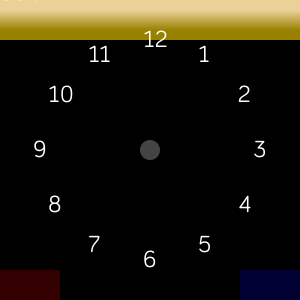

in the end, thanks to all the above comments (and the web), the following code was settled on.
I hope it is of use to others too.
resources/index.gui
<svg class="background"> <gradientRect id="bar" x="0" y="0" width="348" height="40" gradient-type="linear" gradient-x1="0" gradient-y1="25%" gradient-x2="0" gradient-y2="75%" gradient-color1="#ebd197" gradient-color2="#998100" /> <circle cx="150" cy="150" r="10" fill="#444444" /> <text id="test-text1">1</text> <text id="test-text2">2</text> <text id="test-text3">3</text> <text id="test-text4">4</text> <text id="test-text5">5</text> <text id="test-text6">6</text> <text id="test-text7">7</text> <text id="test-text8">8</text> <text id="test-text9">9</text> <text id="test-text10">10</text> <text id="test-text11">11</text> <text id="test-text12">12</text> <text id="text-angle"></text> </svg>
// I have 12 textboxes, named 'test-text1' to 'test-text12' let names = ['6', '7', '8', '9', '10', '11', '12', '1', '2', '3', '4', '5'];
// Angle to place each of the above textboxes. 6 o'clock is at 0-degrees, the rest are at 30-degree increments
let tmpAngle = 0; for (let i=1; i <= 12; i++) {
// get the testbox let c = document.getElementById(`test-text${i}`);
// 110 is the distance from the center (150,150) that the text will be placed on
// the smaller the number, the closed the textboxes will be to the center dot. let a = rotatePoint({x: 150, y: 150}, {x: 0, y: 110}, tmpAngle);
// slight adjustment to make sure things are centered... c.x = a.x - 7; c.y = a.y + 7;
// get the text to show c.text = names[i-1]; c.style.fill = 'white'; c.style.fontSize = 24;
console.log(`test-text${i}, ${tmpAngle}, ${names[i-1]}`);
tmpAngle += 30; } // ---------------------------------------- function rotatePoint(origin, offsets, angle) { let radians = angle * Math.PI / 180.0; let cos = Math.cos(radians); let sin = Math.sin(radians); let dY = offsets.y; return { x: Math.round( (cos * offsets.x) - (sin * offsets.y) + origin.x), y: Math.round( (sin * offsets.x) + (cos * offsets.y) + origin.y) }; }
