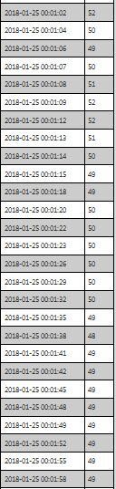

A little late seeing this but here is an example of what I download from a 3rd party source for one minute of my sleeping from my Ionic. Over 24 hours it averages 24 HR points/minute. Typical 35000 plots/day
