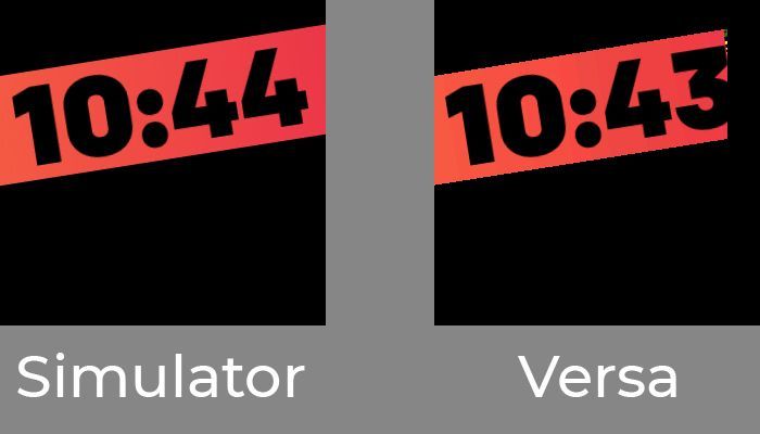

Whenever I try to rotate a <g> containing a rect or a gradientrect that's with a width larger than the screen and with a negative x position it gets clipped on the right side for about the same distance than it's x offset.
In this image, you can see that this issue occurs on the Versa, but not on the simulator, and there's also some yellow artifacts on the upper right edge of the rect.

Unfortunately there are some issues when exceeding the size of the screen and rotating.
If you can put the project on Github I can pass it onto the firmware engineers, they may be able to make improvements in future updates.

I have that issue with wind-direction on my WeatherCast (Weather and Forecast on Github) app.
