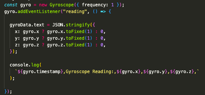

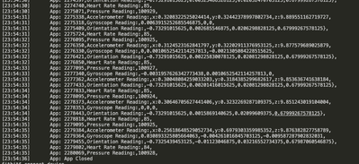

Hello
I try to use console.log for recording the values from multi-sensors.
eg.
On addEventListener "reading" of each sensor return a different timestamp.
Even though the time series appears the left can rely on it.
Is there any solution to synchronous timestamps of these values together?
Thank you,
Parkpoom

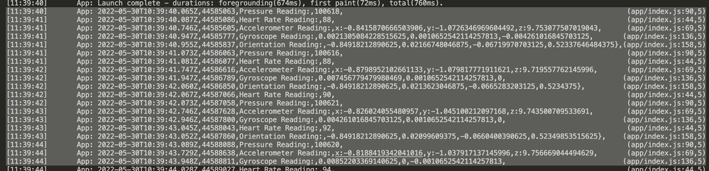

In this post, I would like to share the date time code for each sensor which I use in the reading event. It works for me.
Hope this is useful for developers who may have the same issue.
var isoDateString = new Date().toISOString();
console.log(
`${isoDateString},${gyro.timestamp},Gyroscope Reading:,${gyro.x},${gyro.y},${gyro.z},`
Thank you
