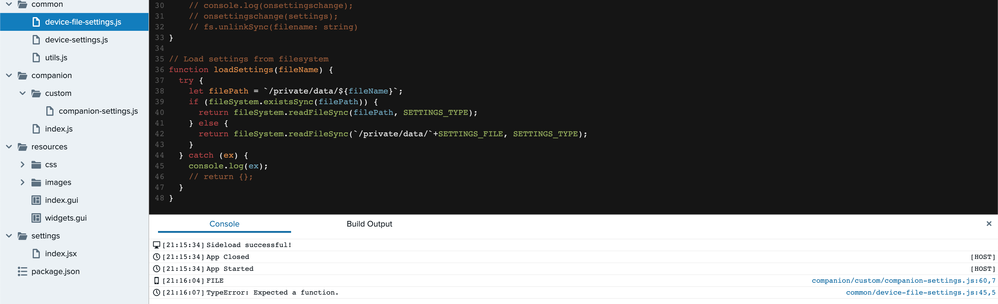

Hi all,
I want to handle settings updates through files not sockets because it's not stable.
I saved the settings in a separate file and used a separate file called common/device-file-settings.js to handle the new received settings file.
I am receiving a strange "TypeError: Expected a function." on line 39, an exception printed on line 45.
I am passing the fs from app/index.js together with the settings callback function in order to use it here.

Hi @Gondwana,
Yes, this is the code:
app/index.js
import * as fs from "fs";
deviceFileSettings.initialize(settingsCallback, fs);
import { inbox } from "file-transfer";
export const SETTINGS_FILE_NAME = "settings";
export const SETTINGS_TYPE = "cbor";
export const SETTINGS_FILE = "settings.cbor";
let settings, onsettingschange, fileSystem;
export function initialize(callback, fs) {
fileSystem = fs;
onsettingschange = callback;
inbox.addEventListener("newfile", processAllFiles);
function loadSettings(fileName) {
try {
var filePath = `/private/data/${fileName}`;
if (fileSystem.existsSync(filePath)) {
return fileSystem.readFileSync(filePath, SETTINGS_TYPE);
} else {
return fileSystem.readFileSync(`/private/data/`+SETTINGS_FILE, SETTINGS_TYPE);
} catch (ex) {
console.log(ex);
// return {};

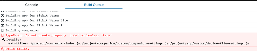

I've moved it directly to the app folder, and when I try to import the fs, a build cannot be created:
"TypeError: Cannot create property 'code' on boolean 'true'"
I am missing some important points.

That's probably something simple, like a typo. If you're using .code in your source, backtrack from there. It sounds like .code is being applied to a simple variable or function return value, rather than an object.
I think you've already discovered the ossapps repo. There's bound to be several things in there that use file transfer (eg, BIG TIME). You could refer to code from there. (Beware of simply pasting: that can create more problems than it solves.)

The error:
Best Answer05-10-2022 02:43
05-10-2022 02:43
Unless I'm misinterpreting, that error message is referring to companion code. fs doesn't exist in the Companion API. You can only access the fs on the device (watch). Don't try to use fs in companion or common directories.
Best Answer05-10-2022 03:07 - edited 05-10-2022 03:31
Hi @Gondwana,
I think what is presented in the log is just the app flow through the watch files:
I do not have any import of the fs into the companion, but only import { outbox } from "file-transfer";
Best Answer05-10-2022 13:43
05-10-2022 13:43
I just tried to duplicate getting a build error reported after "Building companion". The ony way I could do it is if there was a build error in the code that was being built for the companion (ie, /companion/... or /common/...). Build errors in device-only (ie, watch-only) code were always emitted prior to "Building companion".

Hi @Gondwana,
I agree, but the behaviour is weird because I am not changing anything in companion components when I edit in the device-file-settings.js and when I import fs into it, the build fails.

I found the reason why the build is failing.
The fs was loaded in the companion/index.js and I missed it because I was assuming only the import is there:
import * as mySettings from "./custom/companion-settings";
mySettings.initialize();I was having the file like this :
This was causing the build to fail because companion cannot import fs.
