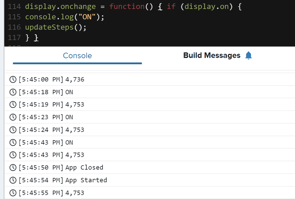

try:
display.onchange = function() {
  if (display.on) {
console.log("ON");
updateSteps();

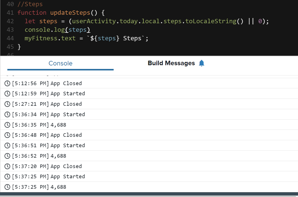

put a console.log inside the updateSteps(), does that output when the display wakes?
Nope, it only logs when I close and then re-open the app. Not from the screen wake.

That seemed to do it. 🙂
Confirmed that the actual steps updated on the watchface as well.
