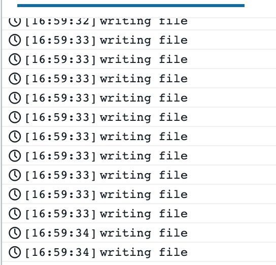

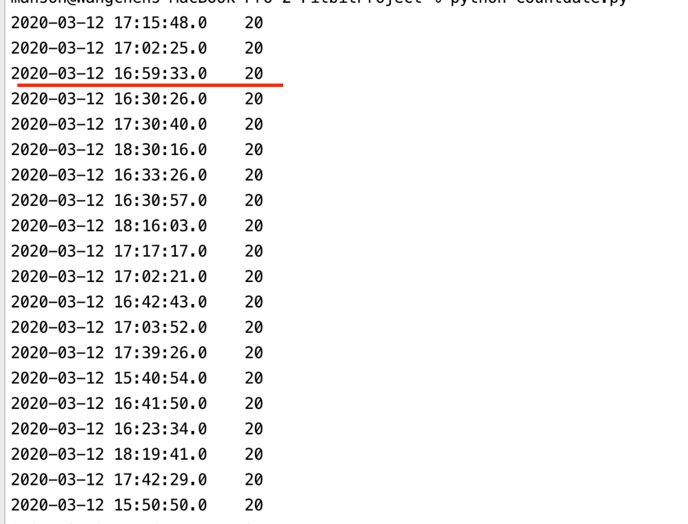

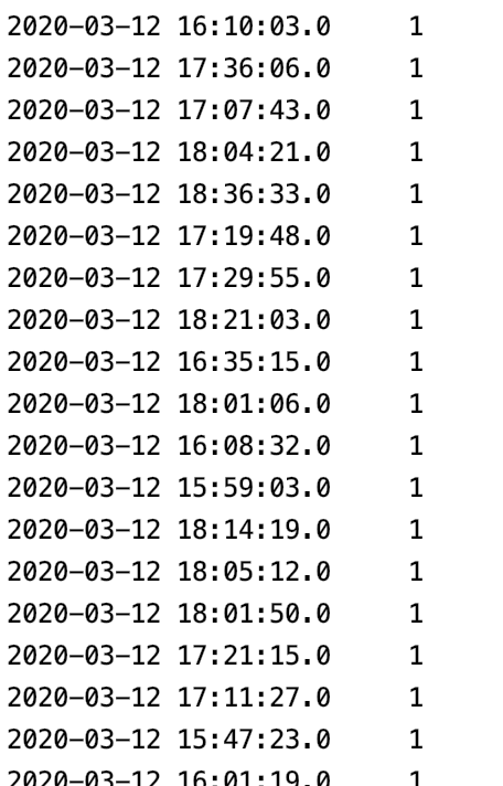

Hi, is it possible to solve this problem???
I set the frequncy as 10 readings per second. I got the data to generated into a csv file and then counted the number of data at each time. However, there are 20 data at these time and some are only 1 data. I checked Fitbit Studio console, at 16:59:33, it only send 10 times. why???
is it hard to get a stable data?
Best Answer03-12-2020 12:53
03-12-2020 12:53
I've never had any trouble getting fairly 'stable' data. The interval between readings fluctuates slightly (16 ms?), but that can't explain what you're seeing.
Writing to file is a relatively slow operation, although I would have thought that 10 times per second should have been okay. You could try saving 10 readings in memory, and only updating the file once per second. Better, use sensor 'batch' mode unless you really need readings straight away.
I'll confess that I'm not sure exactly what some of your images are about.
I still think you should examine the timestamps of your readings to see if you're getting duplicates (which I've occasionally seen!) and to check the actual frequency.
