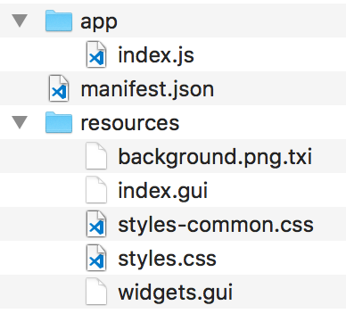

We don't currently have any command line tools, but we're hoping to provide some in the future.
The current build process is done in the browser, basically bundling and tree-shaking using rollup.js.
We bundle the device javascript and convert it to ES 5.1 JavaScript for the device, process png images into txi format, then create a zip file like this for each platform.
Then we bundle and zip the companion, platform zips, and a manifest file into a single zip (named .fba).
